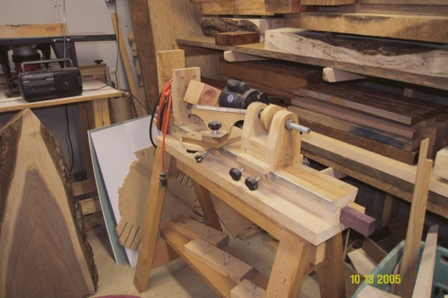

This is a lathe I made from plans in the magazine Shopnotes. It works also.

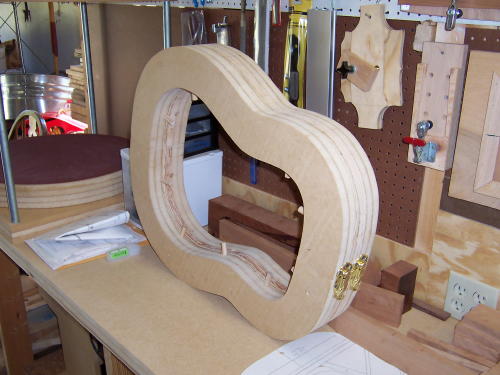

Well given that lutherie is probably half about building ones own tools, here's some of the stuff I've made, some very typical, some not. First the typical stuff.
One of the first things I did when I started building guitars was to make a mold. I built one something like the one Sloane outlined in his book Classic Guitar Construction.
Then I modified it so I could remove the sides. Being able to remove the sides gives me the ability to set a top that still has a border outside the outline into the mold. It makes things a little easier if one installs the neck onto the top (classical construction) before installing the sides.

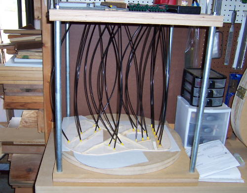

The bending mold and waist caul for my heating blanket setup:

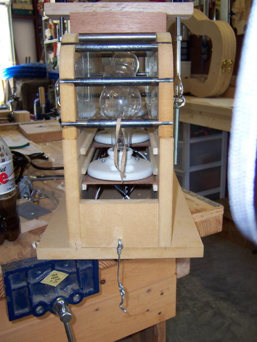

A rosette gluing call next to a through-the-soundboard holddown.

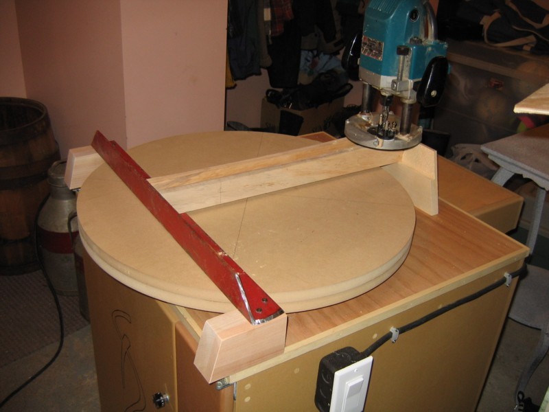

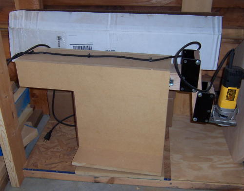

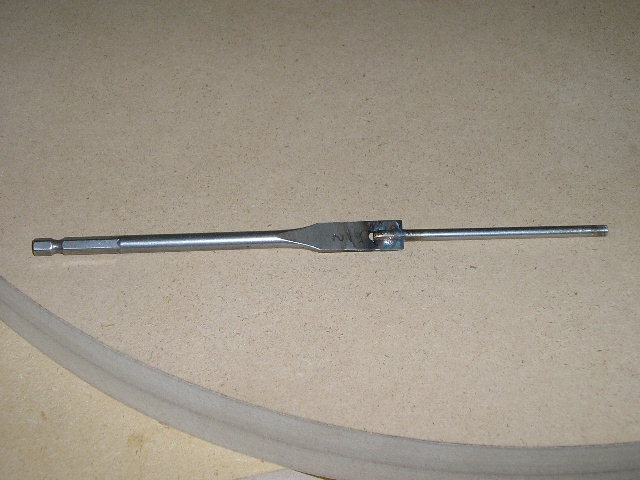

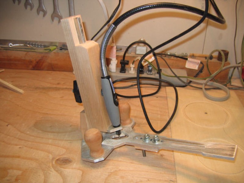

I have a milling machine, so I made my own rosette channel cutter from a few pieces of aluminum. Originally I designed it for a POS Dremel Advantage. After that went belly-up, I modified it to work with my DeWalt laminate trimmer.

The lathe works great. I bolted it onto a saw horse I made, and I also have another saw horse with rails on it and a slot where that piece of purpleheart that sticks out can fit. That makes the lathe capable of holding about a 48" piece. But that gets a little too wobbly for me. I am also, going to cover the belt with a guard.

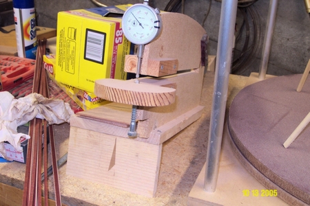

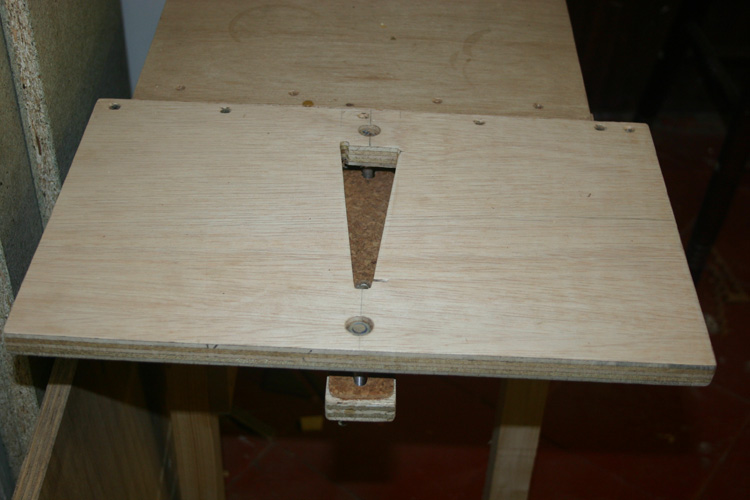

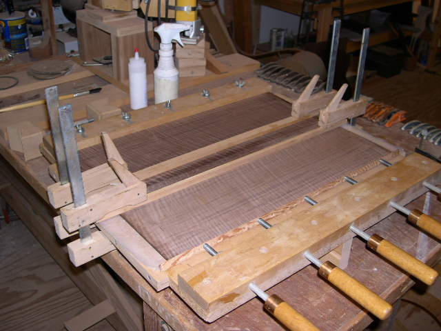

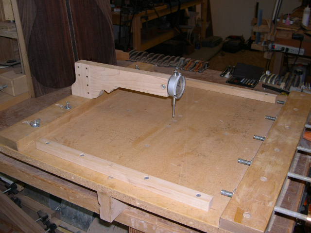

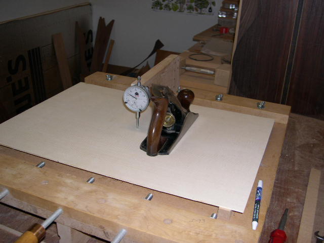

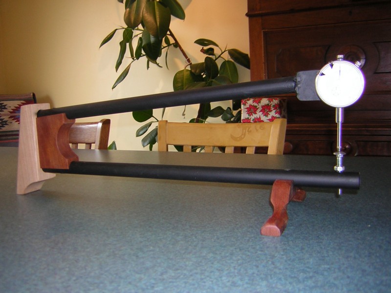

Here's just a few pix of a jig that does double duty.
The first shot is of the gluing jig, which has threaded inserts and all-thread used for the lateral pressure.
Next is the same table, with a maple arm that holds a dial indicator for deflection tests. It is screwed into the adjustable fence on the side opposite the threaded section.
Next is the jig with a top in it and a test in progress. I'm using an old Stanley #4 plane for the weight. Nothing special about that weight, it's just what I started out using, and I'm trying to be consistant.
Thanks for looking,

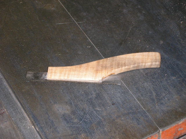

home made fret saw from a stanley flush cut saw, ($12 at home depot). Cut it in half than I epoxyed it into the maple handle.

Stole this one from Marios site and an old post on the MIMF. Works well for my needs of inlay, just need to get some better bits.
The heat is on. 3 200 watt bulbs does the trick.

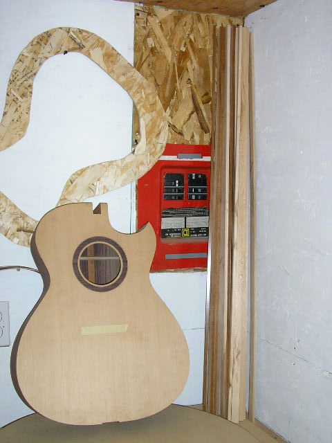

Though I would throw this one in there, the bunch of sticks I use for the go-bars are leftover pieces from my neighbour putting down new maple hardwood flooring. Two, 3" pieces gave me lots of go-bars. Price, loaned him my compressor to put the flooring down.

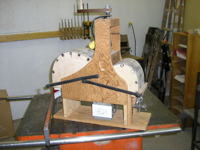

Posts: 697
Hey Rod,

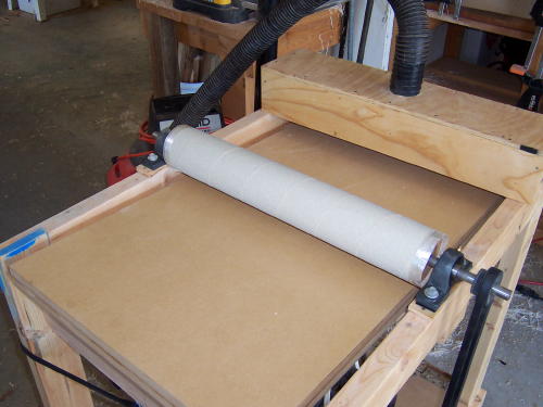

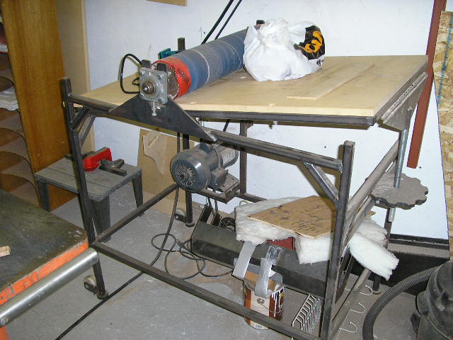

How does that drum sander work for you. I've been looking to buy one, but hey, if I can make it, I'll do that. Where did you buy the drum?

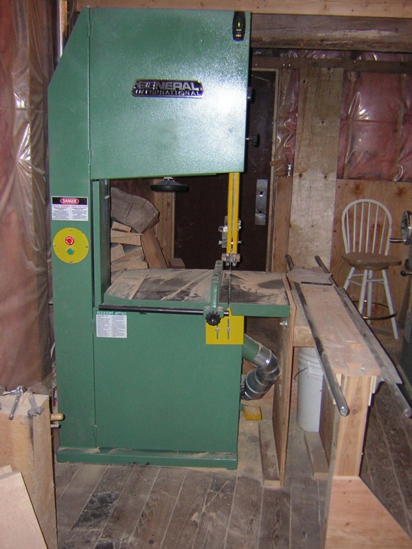

Here's a few more, kind of like Rod, I think of the money spent to make versus buying them but it usually costs as much to make it yourself, but you probably have spent it at an earlier date and now you can collect most of the bits from around the shop. I find great satisfaction in making functional things myself.
Thickness caliper:

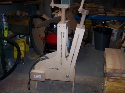

Fox Bender
Dremel base with circle attachment (removable)
Rim Sander with Dish making sled

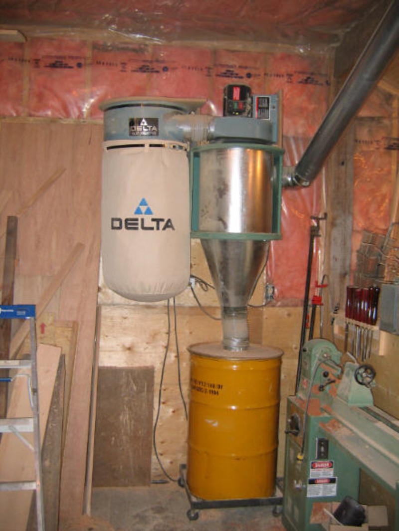

Cyclone Dust Collector

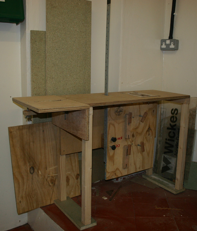

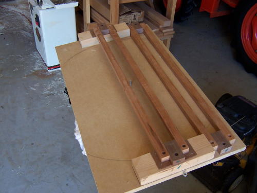

Rails for sliding table on re-saw
Hope this inspires those who are wondering if they can make some of these themselves. There are a lot of good ideas here. I know I will use (did I see "steal") some of them!

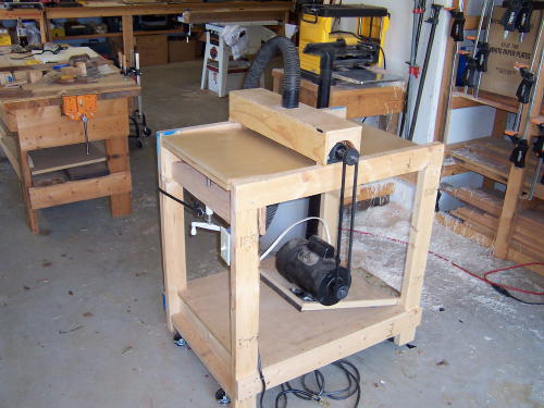

Doug, I use to work at the same steel fab shop that my friend does, (his dad is the owner). I worked as a mechanical engineer tech, (machanical draftsman) I use to help design machinery and other mechanical stuff.
So I had the guys in the shop make the drum for me, I use to draw this kind of stuff up all the time. It's amazing how much work your shop buddies will do for you for a case of beer. That drum took them 12hrs to make, it has a T.I.R of 0.002-0.004" better than I could ever do with MDF and a "flat" sanding board. To align it to the deck I used two milled pcs of steel and adjusted the bearings with a take-up screw I built into the machine.
There are lots of good information out there regarding making a thickness sander and I bet someone here has some plans readily available. I don't have the software that I used to make it anymore otherwise I would just give them to you.
The onlything I need now is an autofeeder for it. Just havn't bothered getting to it yet, but one day soon.
The other thing with the sander is making sure you have it turning at the correct speed. for the first 3 years, I had it turning at 600 rpm, way to slow, now its at full speed and is much smoother and cuts way better.

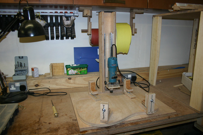

Let me begin by saying that none of these is original. The binding jig is Don Williams design, other things came from others on this forum, the GAL book,LINT, and other places.

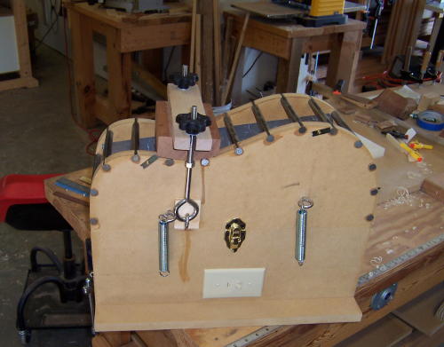

The side bender came from LINT
The sander has a usable area of 20". Works great.

My guitar mold or form. I used two suitcase type latches to close it up.
And I used a hinge on the bottom to make it easy to remove the guitar.

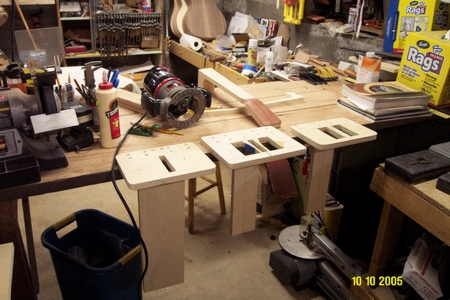

My go bar deck.

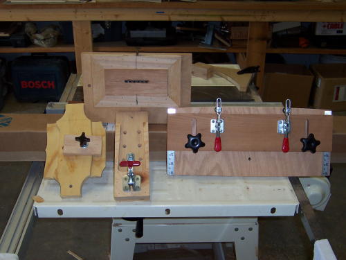

At the top is jig for drilling bridge pin holes and for routing the saddle slot. Left: bridge shaping jig, Center: peg head hole drilling jig, Right: brace shaping jig.
